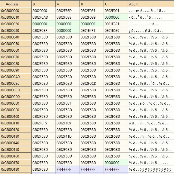

well how do i access the vector table from the code? i looked at .map file. it shows this
.isr_vector 0x0000000008000000 0x184
0x0000000008000000 . = ALIGN (0x4)
*(.isr_vector)
.isr_vector 0x0000000008000000 0x184 Startup/startup_stm32f207vetx.o
0x0000000008000000 g_pfnVectors
0x0000000008000184 . = ALIGN (0x4)
.crc32 0x0000000008010000 0x4
*(.crc32)
.crc32 0x0000000008010000 0x4 Src/main.o
0x0000000008010000 crc_crc32so i think that my firmware length will be at the top of memory, but
none of these values are of firmware size. text + data from :
arm-none-eabi-size SGW.elf
arm-none-eabi-objdump -h -S SGW.elf > "SGW.list"
arm-none-eabi-objcopy -O binary SGW.elf "SGW.bin"
text data bss dec hex filename
191800 564 110424 302788 49ec4 SGW.elfwhat i am doing wrong here?
2020-04-08 5:36 PM
extern uint32_t *g_pfnVectors[];
printf("%p %p\n",g_pfnVectors[0], g_pfnVectors[1]);
2020-04-09 3:33 AM
Thank you so much. it works.
