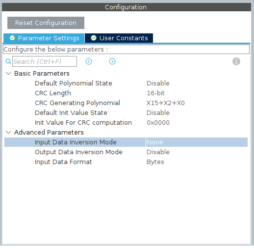

Hi community, I am working on CRC generation with polynomial 0x8005 and initial value 0x0000, so I configured it as below
I am using the data as shown below and the CRC should be 0x43B8 but the value got from the API is different. So I am missing something.
uint32_t bufer[] = { 0x23, 0x41, 0x54, 0x4F, 0x4E, 0xFF, 0x53, 0x4C, 0x30, 0x43, 0x55, 0x52, 0xFF, 0x0A, 0x30, 0x31, 0x32, 0x33, 0x34, 0x35, 0x36, 0x37, 0x38, 0x39 };
uint32_t crc = HAL_CRC_Calculate(&hcrc, bufer, sizeof(bufer));I appreciate your input.

Hi @Community member, It's a typo it must be 0x43BD. I changed the array size to uint8_t and got a CRC of 0xe2cb which is CRC-16/BUYPASS.
2023-05-24 2:38 AM
Hi @Community member, yes you are right it's a typo. The CRC is 0x43BD. But I got 0xe2cb after changing it to uint8_t.
2023-05-24 3:07 AM
As Clive (Tesla) said above, you have to swap the bits order. You did not tell us the STM32 model you are using, but you may be able to experiment with bit ordering in CRC_CR.
2023-05-24 11:04 PM
Hi @Community member, I am using NUCLEO-G491RE development board.
