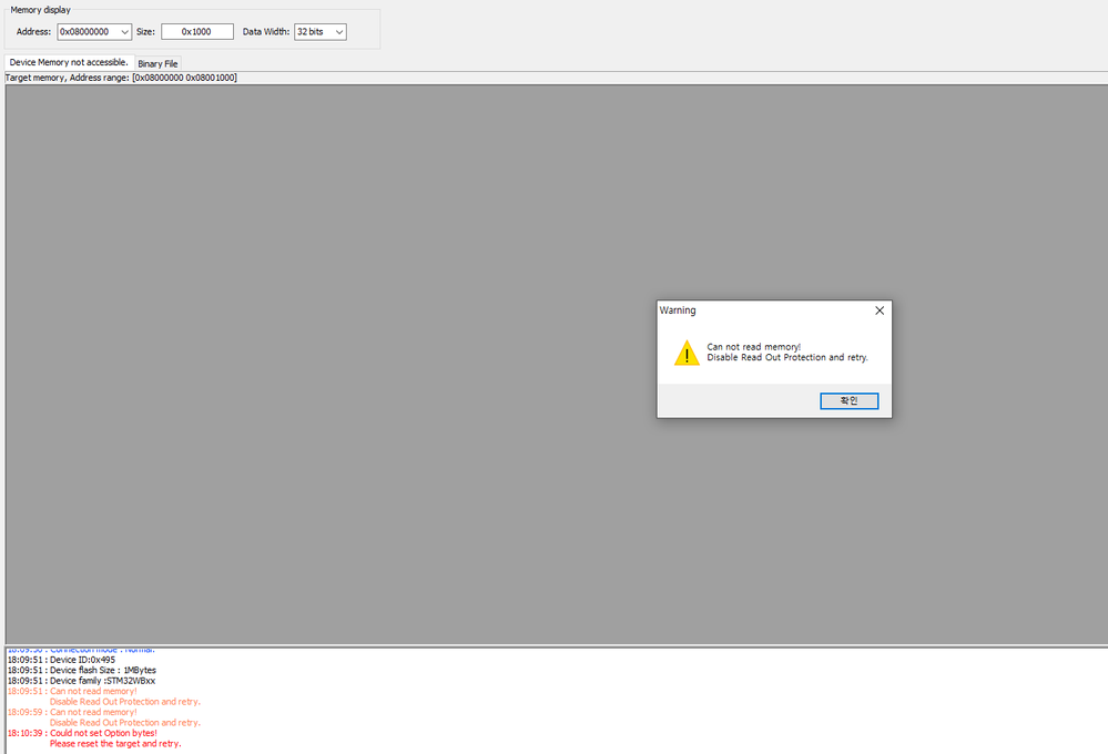

But I can't read or erase flash memory.
It notifies "Can not read memory! Disable Read Out Protection and retry."

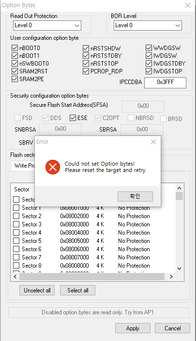

and when I try to change Option bytes, notifies "Could not set Option bytes! Please reset the target and retry."

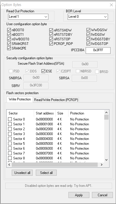

This is the default option bytes.
I think the problem is RDP isn't Level 0.
How can I upload firmware to my custom board or disable RDP?

I see something strange regarding the SFSA option byte. is it 0x00?
If it is, I am afraid the board became unusable. I would like to know what did you do to come to this situation where the complete flash memory is secure and so completely inaccessible.
Normally SFSA is only accessed by the CP2 core. It is only set to 0x00 when an illegal access is done to a secure area. This is one feature of the STM32WB. The goal is to protect the content of the flash in case of an illegal access.
