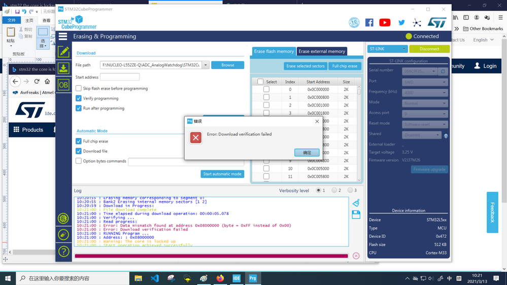

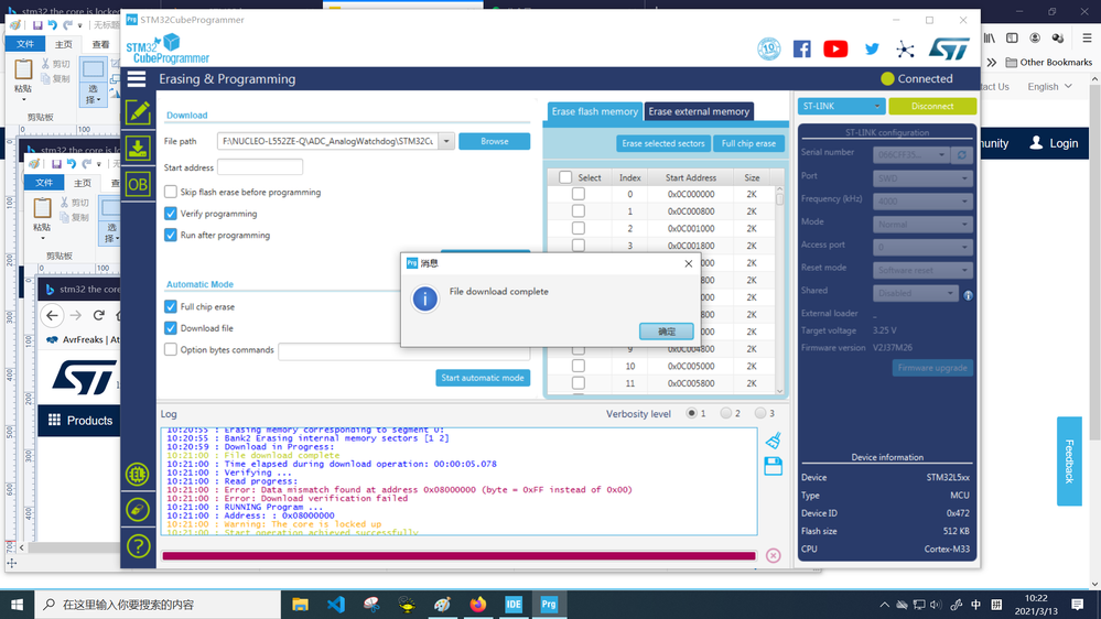

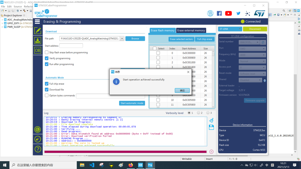

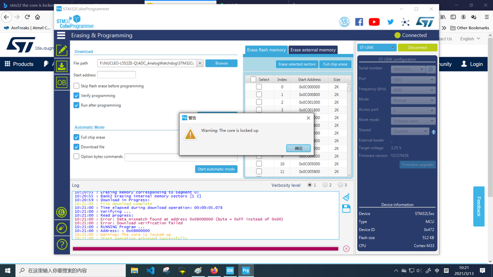

2021-02-11 8:25 AM
i have a similar problem
when trying to flash with stm32cubemx gui some bins
i get the same :

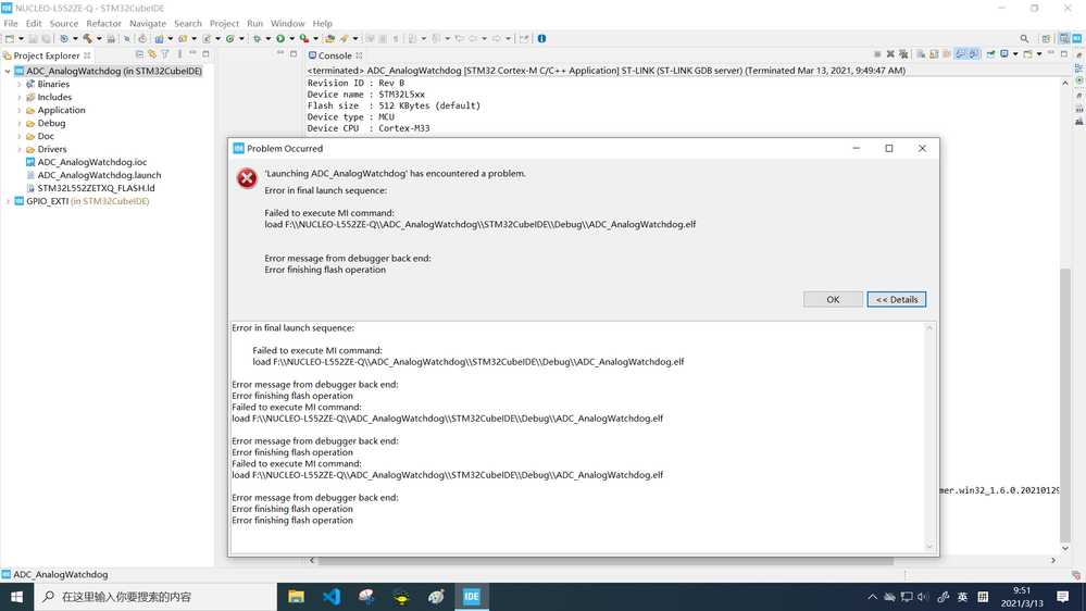

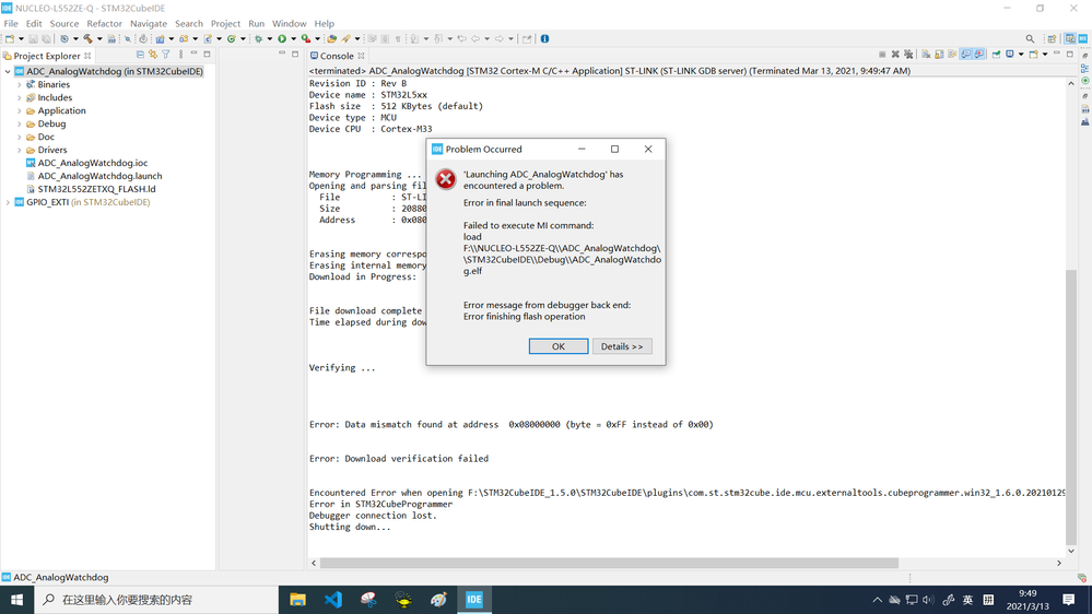

2021-03-12 6:34 PM
PCROP, where is it? I got the same problem:
actually, I met this issue because when I run in STM32CubeIDE, it couldn't download code into the board:
