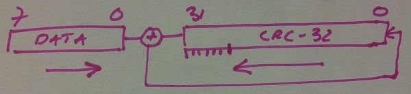

The problem here really is an endian/shift direction one. In terms of what the polynomial is doing, it is the high order 6-bits.
The 8-bit data is LSB first right shifting, and the CRC is 32-bit left shifting 0x04C11DB7. In order to be computationally efficient it makes more sense to stand the CRC on it's head so the data and the CRC shift in the same direction, and a single XOR is required to merge the two bit streams. One could do it in the normal sense of the CRC, but this would require a bit reversal of each data byte. As a bonus, we have the seeding of CRC-32, and the bit-inversion at the end, basically making sure 0x00 bytes generate a check sum2014-05-23 7:13 AM
