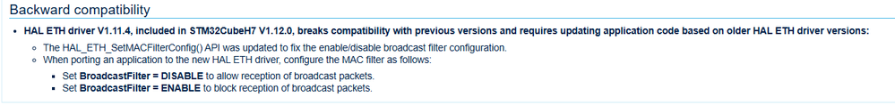

Hello @sssooo,
I just received confirmation from the development team. There was an API change in HAL_ETH_SetMACFilterConfig() in the ETH_MACFilterConfigTypeDef structure for the BroadcastFilter field.
With the new version, the BroadcastFilter field must be set to DISABLE to allow reception of broadcast packets. This is a valid fix, not a workaround.

Hello @sssooo,
