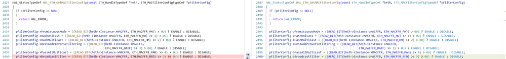

Searching a two days after problems when changing from CubeMX MCU package for F7 series from 1.17.2 to 1.17.3
Seems the same issue:

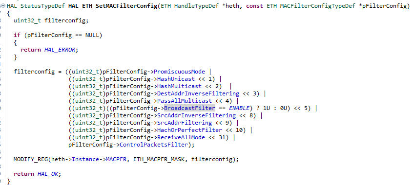

I have checked HAL_ETH_SetMACFilterConfig() against Reference Manuael RM0433 Rev.8. This function is correctly implemented: BroadcastFilter == ENABLE sets Bit5, which blocks all incoming broadcast packets.
The issue is in nx_stm32_eth_driver.c in _nx_driver_hardware_initialize()
Here BroadcastFilter is initialized to ENABLE, which does not make any sense to me, because basic network functionality will not work as described above.
From my point of view, this should be changed to DISABLE in a next realase.

Yes, there is no issue in ETH Driver. The bug is simply the default value auf FilterConfig.BroadcastFilter.
This is the current implementation in FW_H7:
  • BroadcastFilter == ENABLE sets Bit 5 -> all incoming broadcast packets are blocked
  • BroadcastFilter == DISABLE resets Bit 5 -> all received broadcast packets are passed
From my point of view, this is correcty implemented
  • BroadcastFilter == ENABLE means the filter is active, so all broadcast packets are filtered out
  • BroadcastFilter == DISABLE means the fister is not active, so all broadcast packets are reveived
-> BroadcastFilter == DISABLE is what everyone wants.
So the bug is simply the assigned value to FilterConfig.BroadcastFilter in _nx_driver_hardware_initialize().

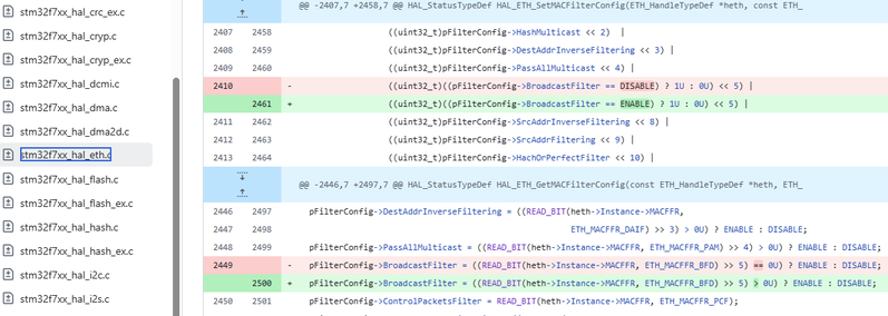

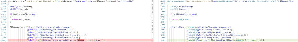

Oops!  In the latest STM32F7 commit, the bug is back??
Commit 58f6d79 on May 16, 2025   - HAL F7 release 1.3.2 or 1.3.3
https://github.com/STMicroelectronics/stm32f7xx-hal-driver/blob/daf38ecc98298d8434a5fab8f5da35e34e4c1695/Src/stm32f7xx_hal_eth.c#L2461
It occurred after FW_F7 package release V1.17.2
Github issue opened: https://github.com/STMicroelectronics/stm32f7xx-hal-driver/issues/24
