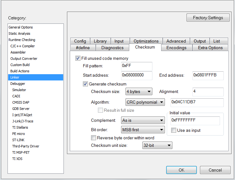

2018-01-29 10:19 AM
So make sure it is going over exactly the same words. Check the computation externally with your own code reading the binary. I could check it but you'd need to provide the binary for me to inspect.
The size should be computed like this
ROM_SIZE = ((ROM_END - ROM_START) + 1) // The way you describe the start/end points describes N-1 rather than N bytes
If you CRC the 0x20000/4 words the residual should by ZERO, at 0x1FFFC/4 words the CRC computed by both sides should match the word at 0x0801FFFC

2018-01-29 8:27 PM
Use your head. The IAR parameters seem to specify an inclusive range, ie bytes from 0x08000000 to 0x0801FFFB, a total of 0x1FFFC bytes or 0x7FFF 32-bit words.
A 32-bit word at 0x0801FFFC (0x0801FFFC..0x0801FFFF) contains the computed 32-bit CRC value.
Of the STM32 you must do a computation that takes 0x7FFF words and pushed the through the CRC.
If you do 0x7FFE words you'll get a different number, which obviously won't match.
If you push 0x8000 word through the CRC i'd expect to see a zero drop out the end and the values cleanly divide into the polynomial.

2018-01-30 6:01 AM
Not sure how __checksum can be located in the middle of the firmware. The variable should presumably be placed at 0x0801FFFC so it is outside the scope of the computation.
Very hard to debug via keyhole, I'd need to see a binary to understand what you've created in IAR
2018-01-31 9:31 PM
Thanks for your support.
__checksum should be located at
0x0801FFFC, My linker was not placing it at end of my ROM.
I have added below line at the end of *.icf file
place at end of ROM_region { ro section .checksum };
I am getting the accurate result I required.
