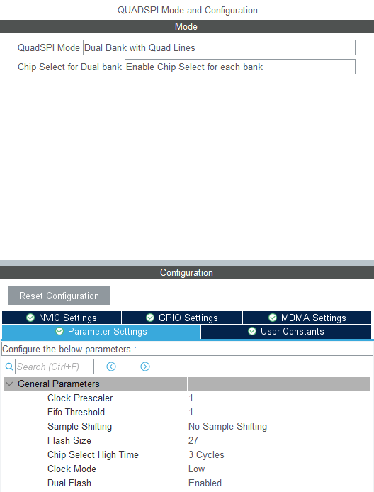

It`s rev V and sysclock is cranked up to maximum of 480MHz.
Also I must admit that I did draw conclusions too quickly. For a few times code above worked but when I got back to work on monday everything was failing at random code fragments. I tracked down the problem in SCB register and it turned out to be "Imprecise data bus", then I`ve changed MPU settings and saw that instructions with random value were given by the QSPI.
It turned out to be problem (bug probably?) with QSPI prescaler. If it is set to 0 (precaller = 1), then situation described above happens.
I`ve also tested for different scenarios:
1.
Clock Prescaler = 0
QSPI clock from PLL = 100MHz
Random Errors
2.
Clock Prescaler = 1
Working
3.
Clock Prescaler = 0
QSPI clock from PLL = 50MHz
Random Errors
4.
Clock Prescaler = 1
QSPI clock from PLL = 200MHz
Working
This is the working setup:
Memory that I use: MX25L51245GZ2I-10G in dual flash setup.
While programming it, I`ve encountered a few more bugs that should be investigated but that`s for another topic.
1.
Clock Prescaler = 0
Random Errors
2.
Clock Prescaler = 1
Working
3.
Clock Prescaler = 0
Random Errors
4.
Clock Prescaler = 1
Working
