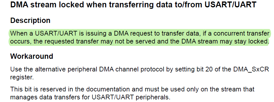

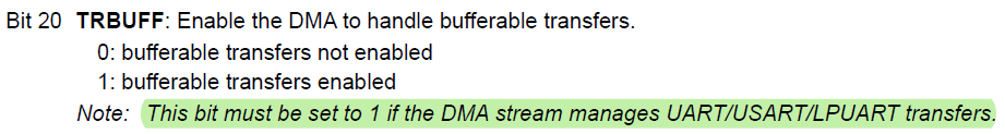

I am using the UART of STM32H747,with DMA transfering data. There is a Note in the reference manual about DMA_SxCR register:
0693W00000WIb6AQAT.pngAnd in the Errata sheet of STM32H743, it says:
0693W00000WIb6tQAD.pngWhat does a concurrent transfer mean? Will the DMA channel transfering UART data be locked? What are chances the DMA channel be locked? How can I make the lock happen in my own project?

A concurrent transfer means DMA is performing another transfer request with other peripheral than USART.
DMA protocol is based on state machine between peripheral request and DMA acknowledge. The peripheral request is cleared when dma acknowledge is asserted.
When using TRBUFF=0, if the application uses several dma transfer with several peripheral (for example ADC and USART). If DMA acknowledge take longer time than expected to clear ADC request, and if at this time an USART request appears, USART transfer will be not served, and DMA stream may stay locked.
With TRBUFF=1, the same issue will not happen because the ADC DMA ack is cleared immediately after AHB transfer completion is ready. So, if USART send DMA request, it will be served.
TRBUFF bit acts as workaround.

Yes, this concerns the dual DMA, but the limitation is on the USART side, not in the DMA.
You are right, this is not documented in the reference manual, but this workaround is explained in the Errata Sheet ES0392 USART limitation section 2.13.2.
