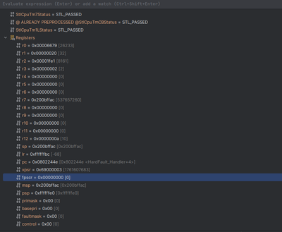

2025-04-14 9:41 PM
Hi Petr Sladecek
We are working on the Class-B on STM32U5 series microcontroller-based product.
Issue:
When we run the TM7 STL test single time, so code is working fine and all STL test are passes but when we run CPU test (Tm1L, Tm7, TmCB) multiple time in every 25ms, the device enters into a hard fault.
Register "-

2025-04-25 6:38 AM
Hi @Petr Sladecek,
When I was disable the interrupt before TM7 test and enable after test, then it will work properly.
Is it correct way for this testing ?
