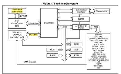

2025-04-25 6:09 PM
The GPIO ports are not connected to the DMA bus on this chip.
You're probably getting an error flag in the DMA when you start the transfer.
2025-04-25 6:09 PM
2025-04-26 2:07 AM - edited 2025-04-26 2:07 AM
Thank you so much. I completely missed that and would have probably sunken so many hours into it.
