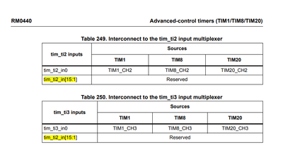

I think there are some wron identifiers?
After reading the manual and seeing the tables i think it must be "tim_ti2_in0", "tim_ti3_in0" and "tim_ti4_in0" on page 1223?
Also in the table on page 1081, there is a "tim_ti2_in[15:1]" that should be "tim_ti3_in[15:1]".
1 REPLY 1
Imen.D
Hello @Tobe,
The first reported typo is fixed in the latest RM0440 Rev 8.
- About the second typo: You are right.
There is a "tim_ti2_in[15:1]" on Table 250. Interconnect to the tim_ti3 input multiplexer, and this should be "tim_ti3_in[15:1]".
I escalated this internally for fix within internal ticket number 178513 (This is an internal tracking number and is not accessible or usable by customers)
