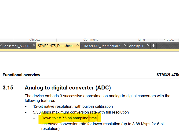

2021-07-17 5:26 AM
The min sample time is 2.5 ADC clock cycles and max.ADC clock is 80MHz, with this the sampling time is coming as 31.25ns but you mentioned as 18.75ns. Here, I think ST has taken the ADC clock cycles are 1.5. I felt it as a bug.
2021-07-27 3:30 AM
Hello @Community member ,
Thanks for reporting this Typo
The sentence is wrong, and it should be corrected as follow:
“Down to 31.25ns sampling time�? Or “Down to 187.5 ns conversion time�?
Imen
2021-07-27 3:30 AM
Imen
2021-07-27 4:11 AM
I have raised internally the DS typo for fix in next release.
Thanks again.
Imen
