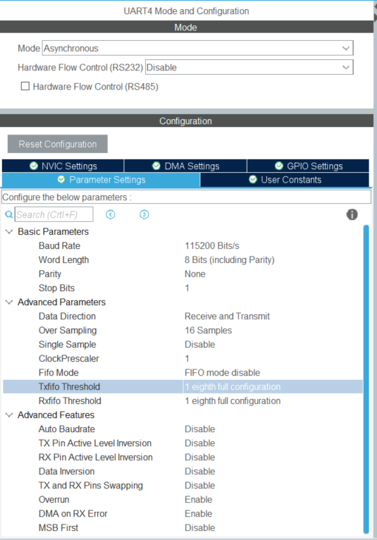

I'm trying to setup a DMA TX UART code using STM32H743VI MCU. The problem I'm facing right now is every time I call HAL_UART_Transmit_DMA function, I get a HAL_DMA_ERROR_TE in my DMA error call-back. The actual line of code is as follows:
char temp[] = "ATI\0";
HAL_UART_Transmit_DMA(&huart2, (uint8_t *) temp, 4U);Strange thing is when I call this function without the temp buffer it works. For e.g.
HAL_UART_Transmit_DMA(&huart2, "ATI\0", 4U);I have worked on STM32F4 series as well and I didn't face this type of problem before. The settings for UART and DMA are as follows:
Any help would be much appreciated. Thanks
