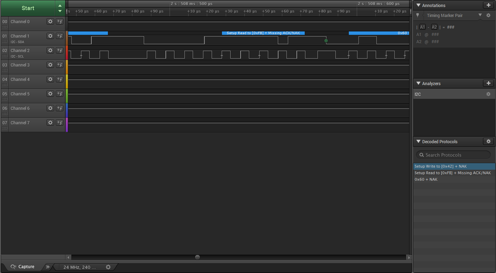

After sending the Device Addr, which is transmitted correctly to the ouput (checked with logic analyser) I send data which is then put to the output wrong. When sending 0x0F I get with the logic analyser 0x1E on the Data line.

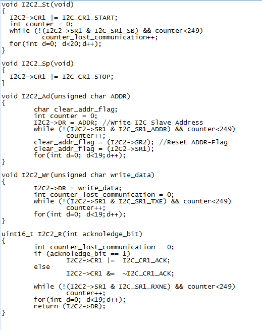

For the I2C communicatoin I'm using a exit counter to leave the otherwise endless while-loops.
I2C2_St();
I2C2_Ad(0x42);
I2C2_Wr(0x0F);
I2C2_St();
I2C2_Ad(0x43);
I2C2_R(1);
I2C2_Sp();Can someone help me how to fix this?

2019-02-10 8:14 AM
Your capture doesn't show the first start bit. the timeframe is too zoomed.
I see only a start bit at the mini green disk.
Logic analyser should be used AFTER a check of I2C lines by oscilloscope.
Maybe toggle a GPIO at the beginning of the I2C sequence to trigger on it with oscilloscope.

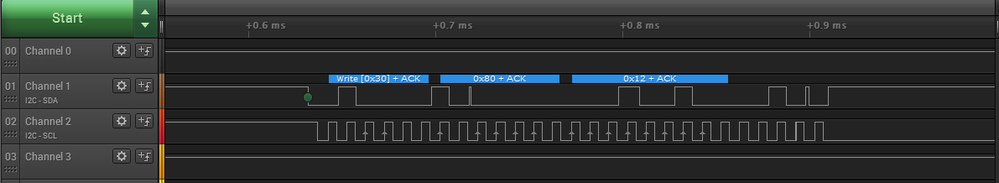

2019-02-10 8:25 AM
added the full waveform:
Image is not available
I hope this helps?

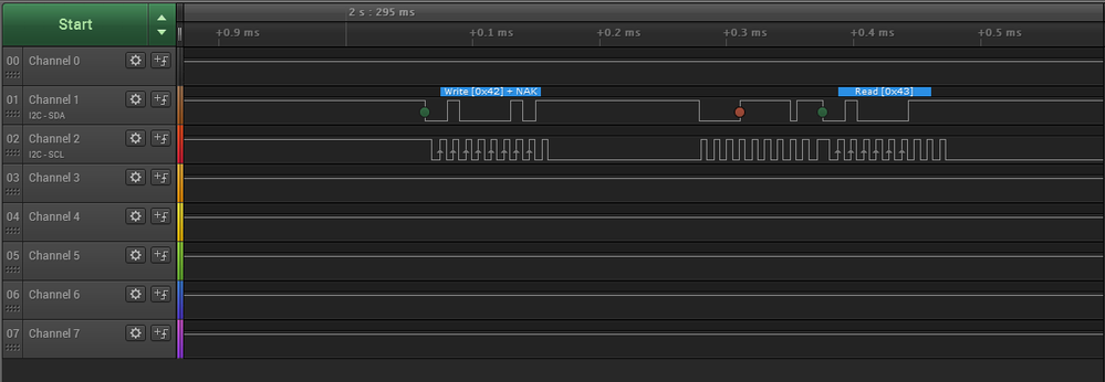

2019-02-10 5:22 PM
I removed the for-dealys and the exit-counter and it is working now.
The problem is now, when Address(write) and Register Address and then Slave-Read Address is transmitted, the master (STM32F4) stopps the SCL Signal. How can I "activate" the clock signal so that the slave can transmitt the data to the master?
Following data is send: 0x42+0x01 then 0x43 and this should be followed with data from the slave.
2019-02-10 6:14 PM
You are missing a restart.
Your oscilloscope seems wrong, it's MSB bit first 0x01 shows up as 0x80.
S-42a-01a-S-43a-xxa-xxn-P
2019-02-11 2:11 AM
thank you for your reply. Please notice that the 0x01 bit you mentioned is the 7th bit of the address (then the 0x01 follows correctly)!
The sensor I'm using is a special sensor which doesn't use directly I2C. The only problem I'm facing, that the STM32F4 doesn't holds up the communication after the 0x43 address. How can I do that?

2019-02-11 9:19 AM
When I add a stop-start condition, the stm32f4 does only send: S-42a-01a-S and the second address and register address is lost.
