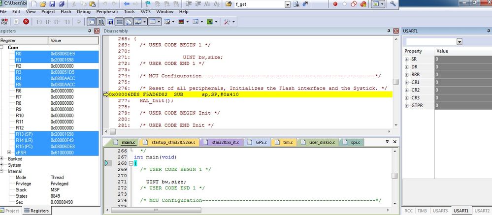

2019-04-11 10:30 PM
this what I got :
the time below is ticking but nothing is happened, I tried to blink 1 LED and no response ???
2019-04-11 10:32 PM
ok, let's see if I 'm not running from main()
2019-04-11 10:38 PM
I try stepping it, it stacks in that loop...
while (1)
/* USER CODE BEGIN W1_HardFault_IRQn 0 */
/* USER CODE END W1_HardFault_IRQn 0 */
