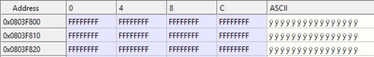

The page I want to write on is empty.
I want to write on the last page, so i define 'FLASH_STORAGE = 0x0803F800'.
