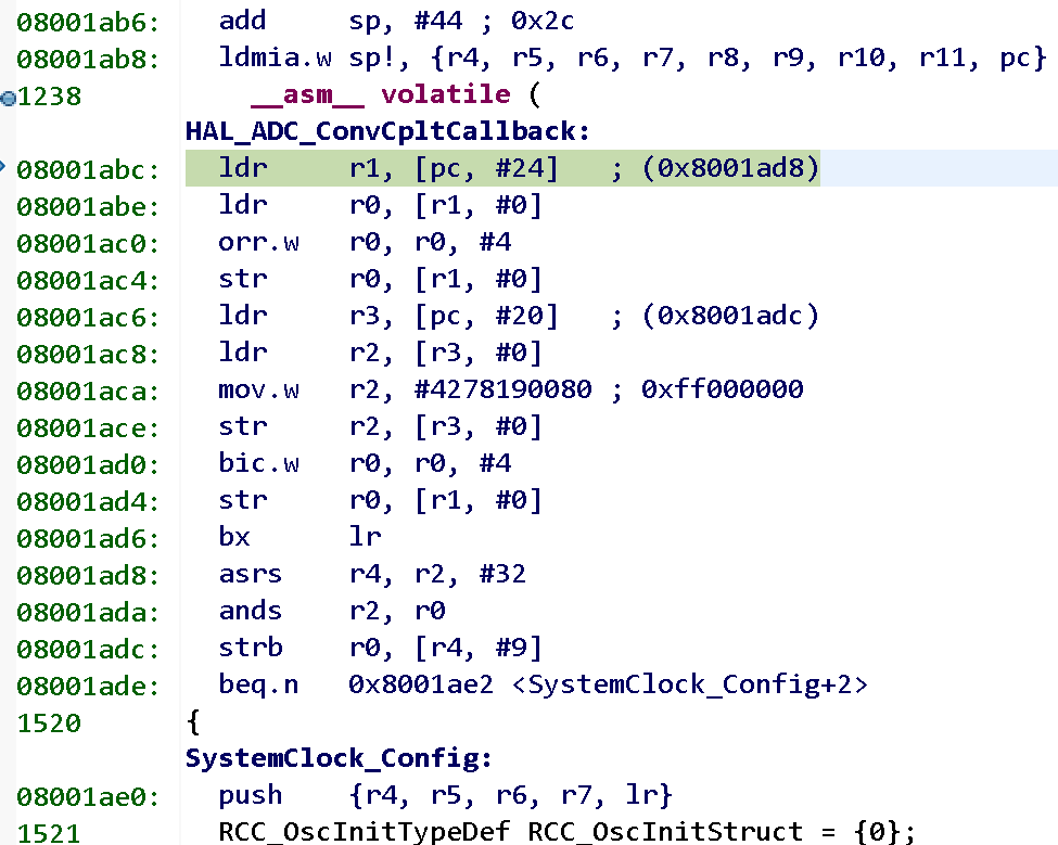

}However the generated code looks like the image below...

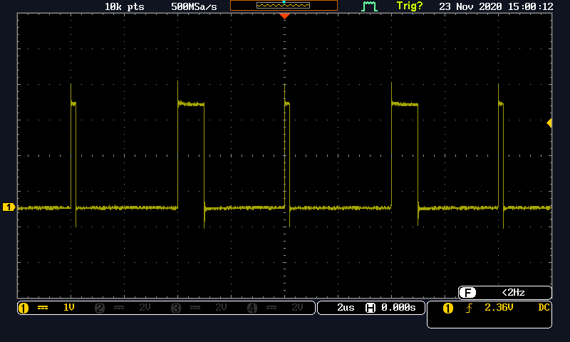

Using this generated code, the GPIO pin to the Oscilloscope produced a pulse with varying width as shown in the image below
From my assembly code above, the pulse width should be more or less identical since I am running the same number of instructions each cycle. But I do not know why I cannot get the compiler to follow the assembly code that I wrote in my C program.

EDIT1: Does anyone know why the compiled Assembly code is not the same as my inline assembly code? I would prefer this part of assembly code to not be touched /modified by compiler optimization while still using the optimize for speed option.
