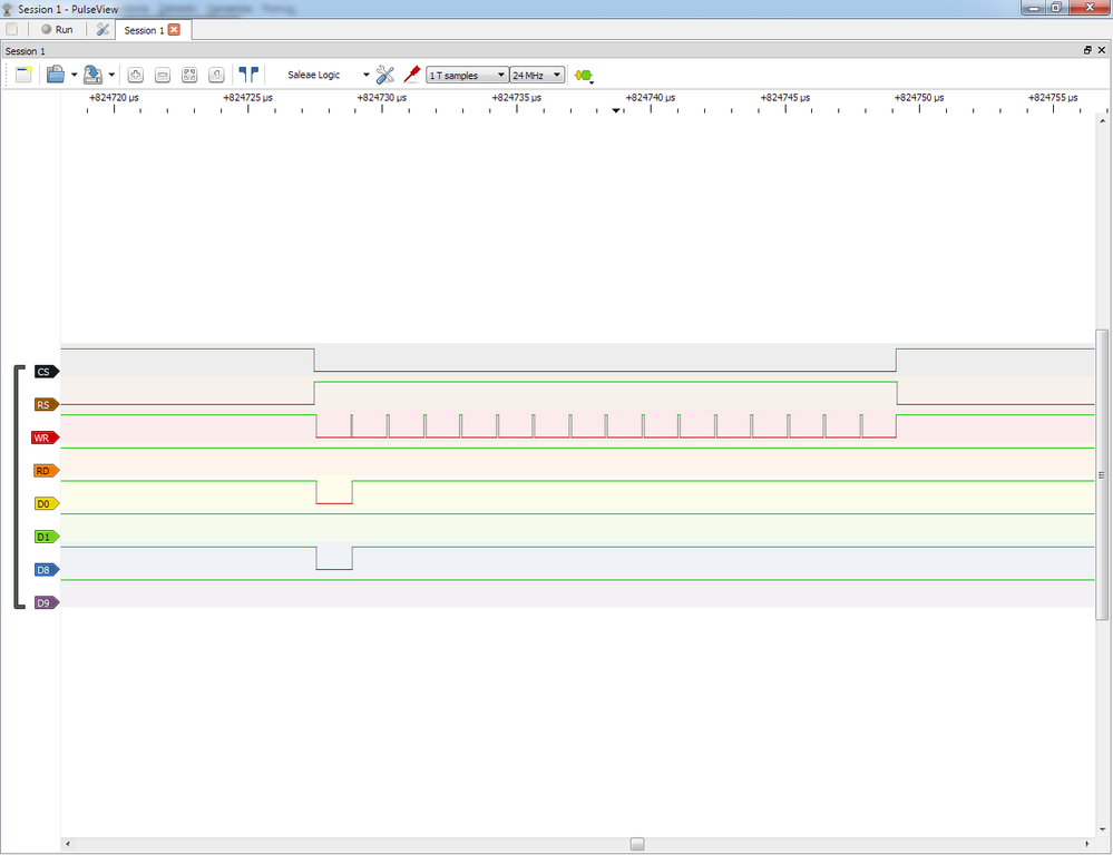

I have the following problem on the micro STM32H743ZIT6:
1) during access to the external write bus, on an SRAM, with only 16 bit bus, occurs when I execute the instruction
* ((uint16_t *) 0x60000000) = (uint16_t) 0xFFFF;
The hardware signals move as follows (/ NE1 yellow, / NOE blue, /WR purple) see attached.
1) It is certainly incorrect because
- /NE1 (yellow chipselect) should only be activated once and not 2.- And / NWR (purple) should only activate 1 within / NE1 and not 2.How come this occurs?
Where am I doing wrong ?
2) The above test was performed with the data cache and code disabled, because otherwise nothing is activated. How can I write externally with the cache enabled?Obviously if it's possible.

What a coincidence, i posted exactly the same problem today.
https://community.st.com/0D50X00009XkWQESA3
. It looks like fmc tries to write entire 64bit block of memory.Regarding 2nd question:
I took a look into FMC SRAM code example from cube package for STM32H743I_EVAL, but this example enables data cache, writes only 512bytes of data, then reads it back. Since DCache have size of 16kB, data is not written into SRAM until cache is cleared/runs out of space (which is never). Then example code reads what it just written to cache without single operation on sram. Way to go...
With cache enabled you can force write with SCB_CleanDCache(); I tried enabling cache, writing one uint16_t and cleaning cache which resulted in this:
After cache clean a wholecache line of 32 bytes was written. Not a problem with interfacing to memory, but in my case i want to write commands to LCD with parallel interface.
This leads me to believe that even with data cache disabled there is something between CPU and FMC with cache like behaviour which results in this weird 4 write accesses... Maybe there is something in core or MPU that i'm not aware of.
