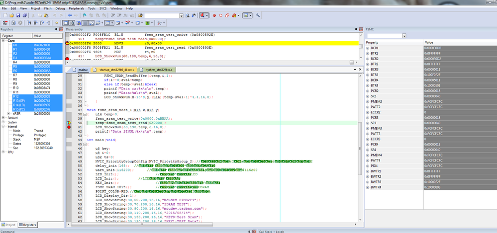

Read out and check/post content of FSMC registers.

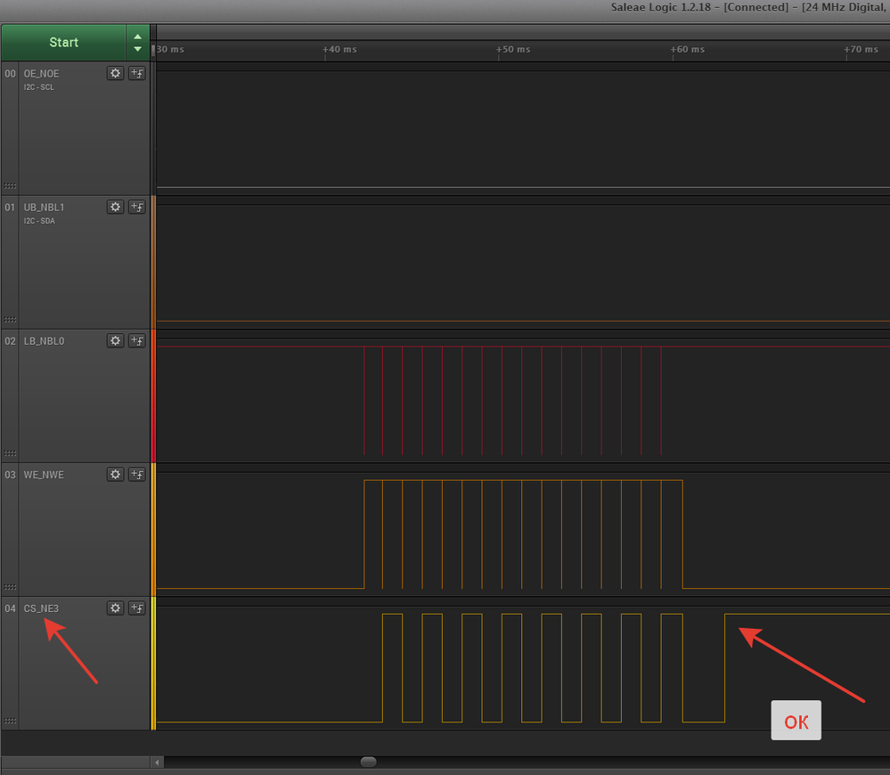

when one of the devices is turned off, the behavior of the CS (NE3 or NE4) signals becomes normal. disconnected separately the memory on the NE 4 logical analyzer; SWITCHED NORMALLY; turned off the screen (by setting comments on the screen); NE 3 switching is normal (attachment). The combined operation of the screen and memory causes a single change in the signal from 1 -> 0 at the outputs of NE 3 and NE 4

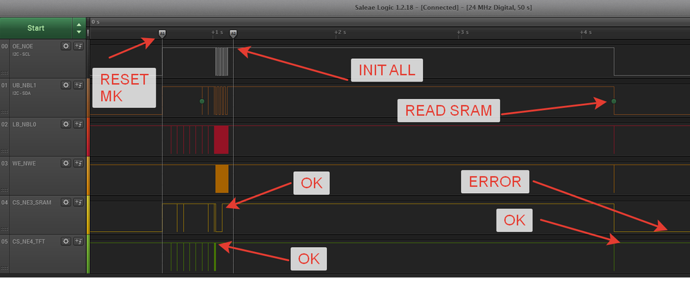

Changed the initialization order, at the beginning of the screen then the memory. The screen selection signal NE 4 now works fine. BUT the memory selection signal does not work. In the attachment, the screen from the moment the microcontroller resets.
Maybe something is wrong with the memory access? I give all the pieces of the appeal code:
