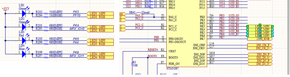

Are all these LEDs directly connected to GPIOs? On some similar H7 EVAL boards two of 4 LEDs are connected thru I/O expander on I2C.
2022-11-08 5:52 PM
All LEDs are connected to MCU directly. I checked in Altium schematics from STmicro and official manual.
Evaluation board is an ST micro product - STM32H757-EVAL.
With provided hex sample, LD1 is turned on and off.
R294,R295,R296,R297 are not mounted in pcb.

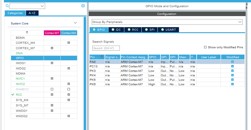

2022-11-27 5:57 PM
Problem solved.
It was hard to set GPIO registers manually, so I set on .ioc file.
GPIOs of STM32H7 should be assigned to core M7 or M4 properly(also Pull-up or Pull-down option and output level option) as picture shows.
