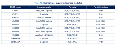

There is a wide range of camera modules and CMOS sensors that are compatible with the STM32 DCMI.
The table below lists some of them.
Also you I advise you to take at AN5020 table 6. some examples of DCMI and camera modules on STM32 boards.
