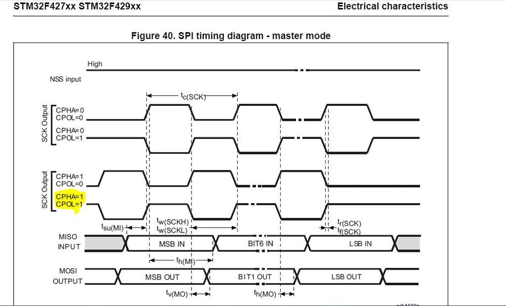

When I am trying to use SPI peripheral, one bit shift in MOSI is observed with respect to Clock.
It is tested in all modes of SPI, still getting the same result in oscilloscope. We are not able to understand this behaviour of SPI.

Master? Slave? What is the content of SPI registers for the displayed picture, and what data are you trying to transfer?
If you've set SCK to highest OSPEEDR setting, switch to slower; if you've set it to slowest, switch to higher.

Check clock phase settings, show initialization code.
2021-03-12 8:06 AM
We have tried with both clock phase rising and falling. The device configured is as master.
In this figure the data transferred is 1 bit i.e. 0x45.
The spi clock frequency set is 350 khz
Here in this figure, we can there is shift of 1 bit. i.e. data transferred is 0xA2.
We have made TI mode disable still the waveform we are getting is likely to be the data transferred in TI mode as per datasheet.
What could be the reason behind this data shift?

The delay between edges is suspicious, as if that picture would show waveforms from two different SPIs... which pins are we talking about? Are there other SPIs active on that board?
Prepare a minimal but complete compilable program exhibiting the problem and post.

for CPHA=1 and CPOL=1 the captured image does not have any bit shift. The output result is 0100 0101 (bit swapped) that is 0x45
Revise the use of pullups or pulldowns resistors (if exist) to fit with clock polarity and the other signals
check SPI registers if have the values that initialization code set.
