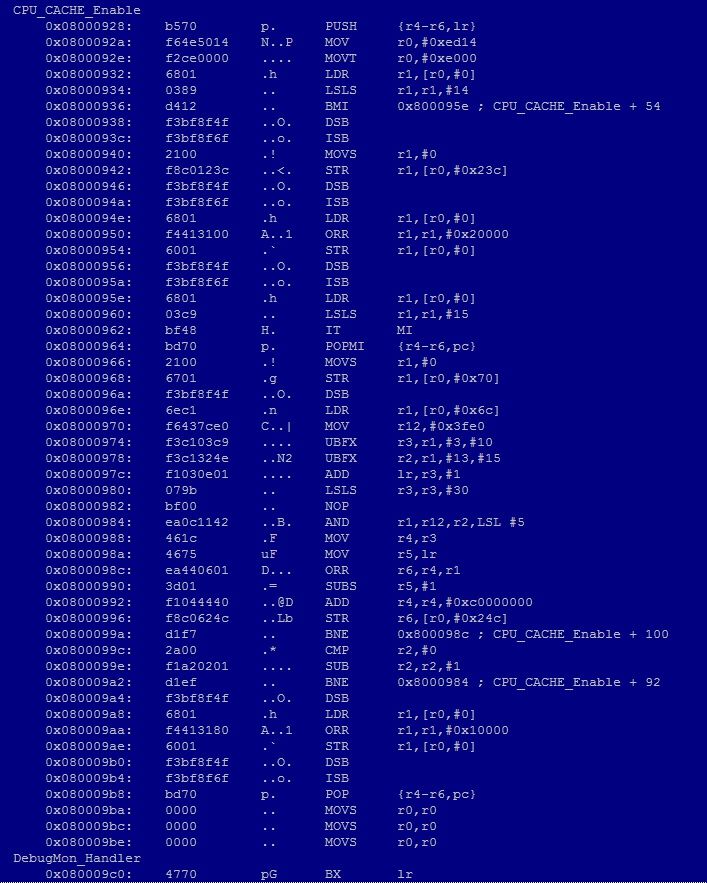

CPU_CACHE_Enable completely folds in
Getting "Maximum number of topic assignments have been exceeded." when posting after adding assembler in code block window (lots of #'s) @Amel NASRI​
In-lining as an image
>>Is the cache already enabled?
This, watch for this, especially in app called by boot loader.
Note new CMSIS checks for this, and forces function to in-line.
The check also has a secondary side-effect of fencing the pending write-buffers (ie implicit DSB)

>>The cache shouldn't already have been enabled, but I can't be sure. I think the crux here is your comment "random use of SCB_InvalidateDCache() has a lot of side-effects, often manifesting in stack corruption" which looks to be exactly what I'm seeing.
The hazard here is that the pending write-back or write-buffers get lost, so the data visible in memory is not reflective of what was written last (most recently). The pending data could be the entire cache-line, and thus all the pushed registers.
What the debugger might be seeing is the processor side cache, not what's in the memory behind it.
