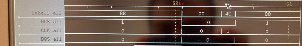

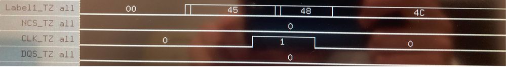

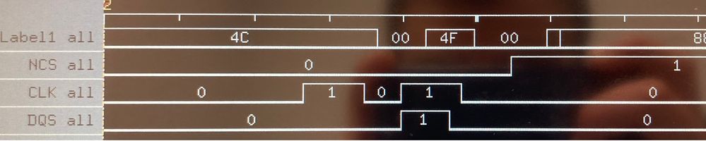

}But when I'm debugging this program with a logic analyser I have frame that doesn't look like an Hyperbus frame.
I have 2 bytes sent then a long gap before the 3 next bytes are sent.
Also the data strobe rise on last byte sent when it should rise on each data.
How can I solve this?
