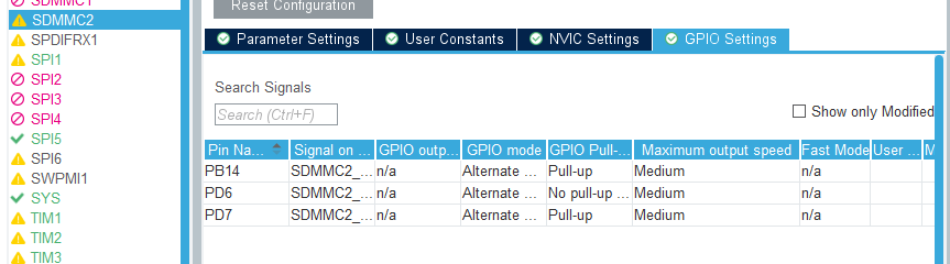

>set all pins to SDcard to lowest possible speed. (medium or low) .
+ what speed setting you use ?

nono....the pin speed setting !
here-> medium
