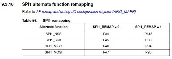

It's just a way to let you choose a different set of pins for the peripheral functions - for the convenience of your PCB design and/or to avoid conflicts with other peripheral functions.
Look at the chip datasheet for details...2014-08-19 7:18 AM
Or more specifically the Reference Manual

Thanks guys,
Then my guss was correct about remap. but I still don't know why he/she has used remap?2014-08-19 11:34 AM
