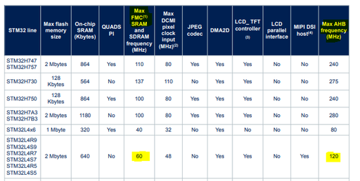

Hello @Majeed and welcome to the Community :),
Are you using other peripherals with same DCMI bus "AHB2"?
According to the datasheet the maximum AHB clock frequency is 120 MHz. However the FMC_CLK is depend on VDD and CL.
For example, for 2.7 V ≤ VDD ≤ 3.6 V, maximum FMC_CLK = 60 MHz for CLKDIV = 0x1 and 54 MHz
for CLKDIV = 0x0 at CL = 30 pF.
Also, I advise you to refer to the AN5020 table 2 to check the maximum frequency of AHB2 and FMC SRAM .
Thank you.
