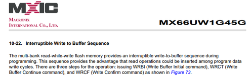

To use only one Flash for reading (executing) and writing, I advise you to follow these steps for the write:
1- First command : write enable (to be set only once)
2- Second command: write buffer initial (WRBI) : Initial write to indicate that a flash programming process is starting. This command must be sent only one time unless the memory goes on error status. Here some read access in memory mapped mode could occur.
3- Third command : write buffer continue (WRCT) : no need to insert a new write enable.
4- Last command : Write confirm command (WRCF) : The physical programming of the memory starts here after receiving the WRCF command. A page will be programmed.
If you need to program another page, you need to pool the status register to see if the physical write is finished.
