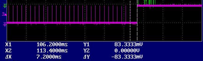

During transmission and reception using STM32U585 LPTIM+SPI+LPDMA, noise to SPI3_SCK causes a fatal bit shift in the bitstream.
The condition on the left is normal and the oscilloscope waveform can be received exactly as expected.
However, if you introduce noise that shorts the SPI3_SCK terminal to ground, the state shown on the right will occur and the bits will continue to be received with a shift (11 bits in this example. It will change each time you try). There is no problem with the transmitting system, and only the receiving bits are shifted.

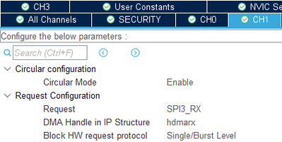

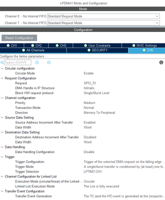

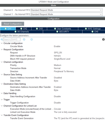

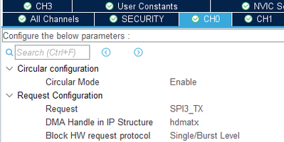

This system uses STM32U5 as the master and sends and receives data to and from slave devices. LPTIM3 operates in PWM mode and is used as a chip select for the slave device, as well as two LPDMA requests. LPDMA is in circular mode and performs SPI transmission and reception. It operates autonomously.

LPTIM3_CH1 is the trigger for LPDMA1_CH0. Start SPI3_TX
LPDMA1_CH1

Operation at the moment of short circuit
The moment SPI3_SCK is shorted, the interval changes from 4ms to 7.2msec. Read the CBR1 value in the interrupt handler and stop at the breakpoint.
7.2msec (varies approximately between 6~18msec)
