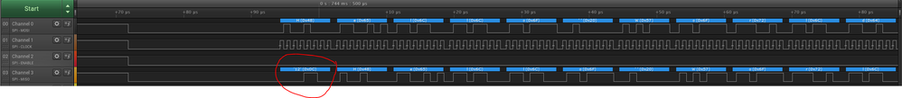

So, there should be no any SPI receivedata from MISO, but when I look the data at the logic analyzer, the MISO sent back the data from MOSI. It is like echoing, Or Is it because of the SPI nature?
this code I sent "Hello world!" the string length is 12.
First, I send the length of the string to the slave, Then, I send the Hello world! sentence to the slave.
the thing is, every data transmit from the MOSI, there will be a data sent back from MISO which is the sentence of the Hello world!
example in my picture, when I send the length 12, the MISO will exchange the " ! ". which is the last letter of hello world!
Then, when letter H is being sent, the MISO will reply back the length of the string data which is sent previously. Why is this happening? anyone can help me?

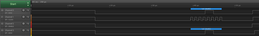

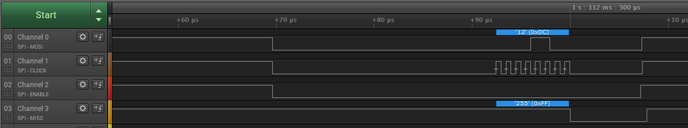

I try to send the length of the string only to the master, for the first transmission, the MISO return 0xFF, I where does this value come? is it from the register that has not yet been cleared from MISO?
because after I do second transmission, the MISO return 0x0C which is the string length that I sent before.
