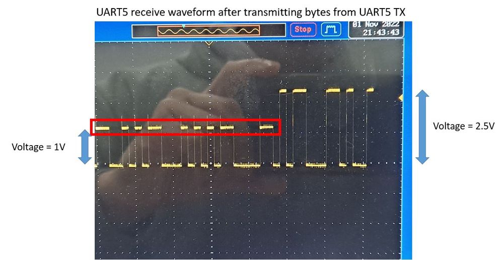

The UART5 receive data waveform after I transmit from UART5 TX is below : TTL connection setting.

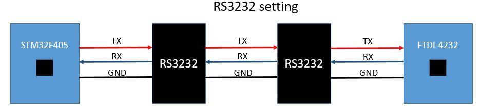

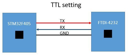

I connected them to FTDI directly through TTL interface and through RS232 interface. But I get same behaviour in both of them.
The TX/RX cross connection is verified because I have transmitted and received bytes simply. And the ground connection in all of the boards are also common.

Looks to be a hardware side issue.
How exactly do you have this wired up? What board?
Common Grounds?
Cross connected or shorted to a secondary pin?

My connections are shown above. Hope they answer your questions. The TX and RX are crossed accordingly and the systems have common ground.
Even I thought it to be hardware issue, but after checking with USB-TTL converter directly and connecting through RS232 converter in between as shown in figure above, I have suspicion in interrupt receiver.
