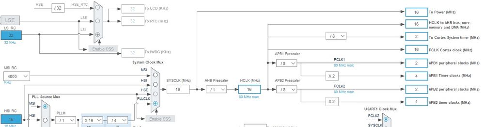

These are the clock settings I'm using:

So 20 system clocks. That's consistent with 12 system clocks of ISR latency + 2 system clocks to load r3 and r1 from FLASH + (0..7) + 8 system (AHB) clocks to get through the AHB/APB bridge with APB running at AHB/8 in order to load r0 from TIM_CNT. Give or take a couple of clocks, for I don't know exactly how things are synchronized.
