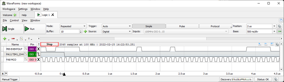

Here is a STM32L432 running at 10 MHz with a little instrumentation:
3rd row: MCO out @ 10 MHz
2nd row: TIM1 CH4 used as PWM with pulse=20. IRQ triggered w.r.t. falling edge
1st row: EVENTOUT signal
The EVENTOUT signal is triggered high in larger chunks (left, right) in the main loop, only low when the loop branch occurs:
while (1)
__asm__ volatile ("sev": : :"memory");
/* USER CODE END WHILE */
/* USER CODE BEGIN 3 */
}and also triggered in the IRQ handler (2 short pulses in 1st row):
void TIM1_CC_IRQHandler(void)
/* USER CODE BEGIN TIM1_CC_IRQn 0 */
__HAL_TIM_CLEAR_IT(&htim1, TIM_IT_CC4);
return; // do not use HAL HandlerThis sums up to 38 clock cycles, 2 of them could be spared (sev from IRQ)
