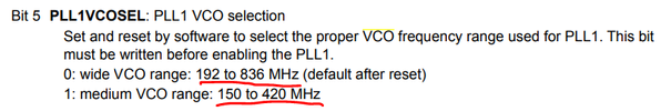

Hi, I am using STM32H563 Nucleo board, and found the PLL1VCOSEL bit of RCC PLL clock source selection register.
There are duplicates in the settings.
Does anyone know why is the settings duplicates?
I would like to know why and use case.

There is no duplication in the settings. The PLL proposes 2 VCO settings:
  • The VCO range 192-836 MHz can be used with an input frequency of 2 to 16 MHz. The wide frequency range offers a broader frequency spectrum, which can be useful for applications requiring higher frequencies.
  • The VCO range 150-420 MHz can be used for an input clock of 1 to 2 MHz. The medium frequency range was implemented for applications such as audio. In audio, you need to generate specific frequencies with high accuracy.

I do not see a duplicate setting.
The medium VCO range setting needs less current. See datasheet 5.3.10
