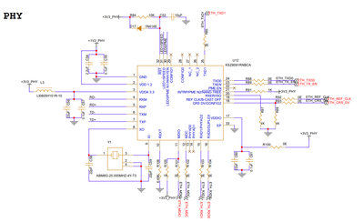

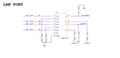

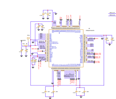

Hi Imen,
Thanks for your response.
I followed the configuration steps as outlined in your PDF, but unfortunately, I’m unable to bring up the interface.
Attached, you’ll find the schematic of our PHY IC for your reference.
Could you kindly suggest any alternative methods to verify whether our hardware is functioning correctly.
Thank you for your assistance.
Hello @Vista123 ,
If you want to make sure that the hardware is working correctly you should try to read/write to and from the PHY registers if this operation is successful then normally you should be good to go.
this could be done using
         (##) HAL_ETH_ReadPHYRegister(): Read a register from an external PHY
         (##) HAL_ETH_WritePHYRegister(): Write data to an external RHY register
