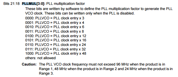

Back to this discussion in order to more understand the case:
1- to know the maximum ystem clock frequency, you have to refer to the datasheet of your product (General Operating Conditions). It is 32 MHz
2- In UM1749 as well as drivers in the Cube package, the 96 MHz is the maximum PLLVCO clock frequency. It is related to the configuration of PLLMUL as described in the reference manual:
-Amel-
