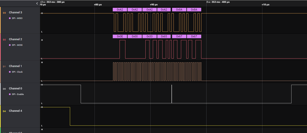

Hello I'm using SPI to interface my STM32F7 with the SX1262 radio.
I got a weird behavior, I'm using a GPIO to toggle the NSS pin. But sometimes it toggles randomly during the data transfer. You can see on the following screenshot of my logic analyzer:

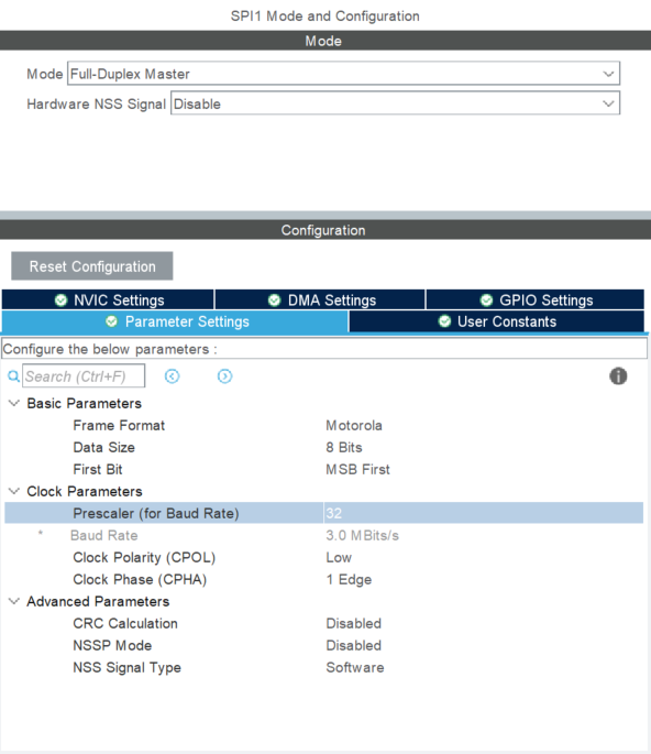

}Here's the SPI setup:
2022-08-26 10:54 AM
If you have flying wires or a long ribbon cable, this may be result of inadequate ground/return arrangement and/or crostallk.
If this is the case, the remedy is short cables and individual ground/return for each signal. You can try to work around this by increasing the NSS pin's drive by its GPIO_OSPEEDR setting, and decrease other pins' drive.
LA may not be the most adequate tool for this kind of problems.
2022-08-26 10:54 AM
2022-08-26 11:40 PM
Measure NSS pin by oscilloscope.
2022-08-27 12:28 AM
I suspect other code write other pin of same port, or memory pointer wrong writing. Try the debug watchpoint on the gpio out and bssr or moder register.
2022-08-27 6:02 AM
HAL_SPI_Transmit() is supposed to make sure the transmit completes, ie Tx FIFO empty, not busy, RX FIFO empty.
Not sure why this pin would glitch,would have to be a direct connection with something else or some other code. Anything in an interrupt or callback?
Any error or status returned by the commands?
2022-08-28 9:47 AM
It was a wiring problem after all!
Thank you for the help
