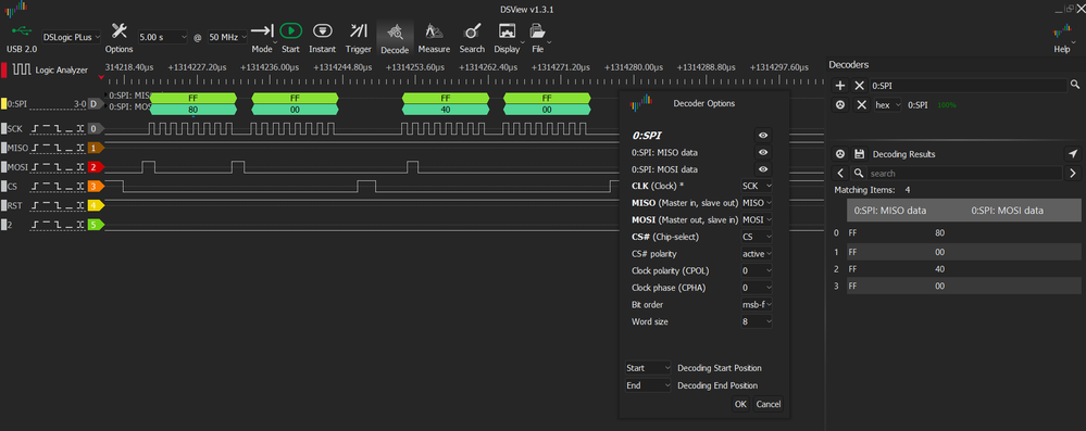

I don't think it's power. There is designated 5V LDO L7805 giving power to both MCU and RA8875. Here is the logic analyzer output. Here is full source code if it helps at all.
