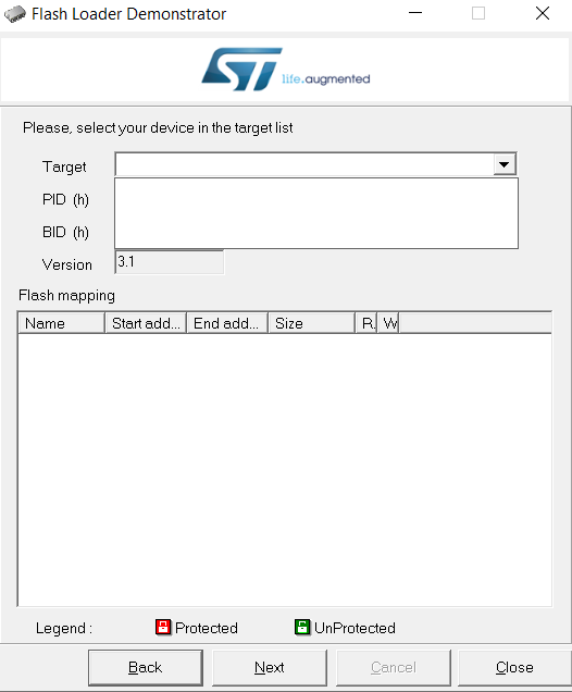

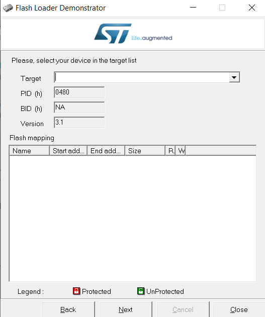

I'm using the STM32 H7A3Zi-Q Nucleo-144 development kit. While I'm trying to enter to the bootloader by connecting BOOT0 pin to the 3V3(VDD) pin & I'm using the ST toll called Flash Loader Demonstrator in order to achieve the same. While I'm doing it so, I'm not getting the list for the target

This is an old tool not supporting the H7 and not being maintained.
Use STM32 Cube Programmer as it also supports USB and UART based connectivity to the ROMs system loader.
