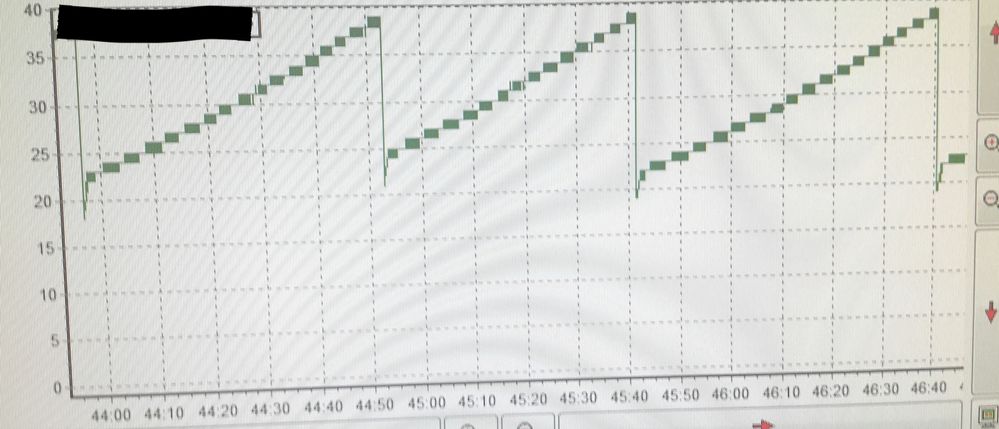

I'm working on TSC, whit Stm32f051. At the end of equasition, I read the counter(TSC->IOGXR). this counter increses smoothly in period of time. After a certain level, it fall down(like the sawtooth wave).
My code is very simple az shown below:

The pictuer of sample is shown below:
Why does this happen?

I found the problem.
When I change the the GPIOx_OSPEEDR to zero, it worked well. But other confige the problem exists.
Can any body help why?
