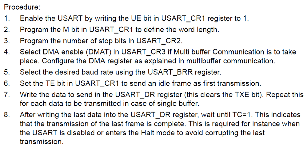

My setup uses a STM32407VG. I have been using for some time now and have gotten used to how to read the datasheet and use some of features. Today I am trying to get UART4 transmitting some data.
Here is how I went about getting it all setup:
I did step through the debugger (via STLINK) and it appears I am setting all of the correct bits. But when I land on that UE bit, I get the error (in the console) Target is not responding, retrying… until it times out. Below is a code snippet.

Might not be it, but the RM says to enable UE first, then do everything else.
Code is easier to read if you use standard defines than custom bits
UART4->CR1 |= (1U << 13); --> UART4->CR1 |= USART_CR1_UE;
Custom board? Make sure PC10 isn't connected to anything else that will disrupt the debugger. Set it as GPIO and toggle it.

You're still not doing the correct order of initialization. TE should be last.
I would test the code on known good hardware such as a nucleo board. Upload your schematic if you want.

Sorry about that! I was careless with the pasting of the up to date code. Here it is:
void UART4_Config()
// Enable GPIO C
RCC->AHB1ENR |= RCC_AHB1ENR_GPIOCEN;
// UART4 TX PIN GPIO SETUP
GPIOC->MODER &= ~(GPIO_MODER_MODE10); // Clear pin mode field
GPIOC->MODER |= GPIO_MODER_MODER10_1; // Set pin mode field as alternate
GPIOC->OTYPER &= ~(GPIO_OTYPER_OT10); // Clear output type field (push-pull by default)
GPIOC->OSPEEDR &= ~(GPIO_OTYPER_OT10); // Clear output speed field (low by default)
GPIOC->OSPEEDR |= GPIO_OSPEEDR_OSPEED10_0; // Set to medium speed
GPIOC->PUPDR &= ~(GPIO_PUPDR_PUPD10); // Clear pullup/ pulldown mode field (none as default)
GPIOC->AFR[1] &= ~(1U << 8); // Set alternate function to be AF8, bit 8
GPIOC->AFR[1] &= ~(1U << 9); // Set alternate function to be AF8, bit 9
GPIOC->AFR[1] &= ~(1U << 10); // Set alternate function to be AF8, bit 10
GPIOC->AFR[1] |= (1U << 11); // Set alternate function to be AF8, bit 11
// STEP 0 - Enable the bus to UART4
RCC->APB1ENR |= DKO_UART4_ENABLE;
// STEP 1 - Enable the UART (PC10=TX PC11=RX) by setting the UE bit (uart enable bit)
UART4->CR1 |= (USART_CR1_UE);
// STEP 2 - Set the M bit
UART4->CR1 |= (USART_CR1_M);
// STEP 3 - Set the stop bits
UART4->CR1 |= (USART_CR2_STOP_1);
// STEP 4
// NONE
// STEP 5 - Set baudrate to be 19200; formula is BRR = [pclk + (baud/2)] / baud
UART4->BRR = 4376;//2188;
// STEP 6 - Set the TE bit
UART4->CR1 |= USART_CR1_TE;
}I think the 1kohm pullups really messed up the UART. Took some hot air and removed them, did the trick. Now I am finally getting some clear data. Thank you for the help! Where can I place some money to buy you a coffee? :p
