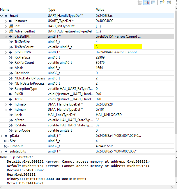

When using the default project generated my UART works fine and I can see the output on my Putty terminal. Now for my application I'm trying to move the UART object to another file.

void UART::printMenu(){
uint8_t buff[4] = {3, 4, 5, 6};
HAL_UART_Transmit(&huart3, buff, sizeof(buff), HAL_MAX_DELAY);
char const *another = "Hello, world!\r\n";
HAL_UART_Transmit(&huart3, (uint8_t*)another, 17, HAL_MAX_DELAY);
}Using the debugger everything is going fine, except there is nohing to be seen on the Putty terminal anymore. I think I found the issue because it can't access the memory of the buffer;
Anyone knows how to fix this issue?
Edit: probably caused by the INIT function not working as expected

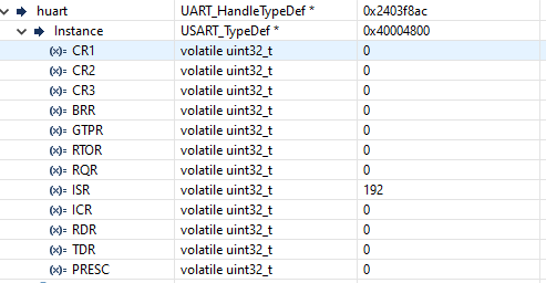

/*-------------------------- USART CR1 Configuration -----------------------*/
/* Clear M, PCE, PS, TE, RE and OVER8 bits and configure
* the UART Word Length, Parity, Mode and oversampling:
* set the M bits according to huart->Init.WordLength value
* set PCE and PS bits according to huart->Init.Parity value
* set TE and RE bits according to huart->Init.Mode value
* set OVER8 bit according to huart->Init.OverSampling value */
tmpreg = (uint32_t)huart->Init.WordLength | huart->Init.Parity | huart->Init.Mode | huart->Init.OverSampling ;
MODIFY_REG(huart->Instance->CR1, USART_CR1_FIELDS, tmpreg);While debugging I can see the CR1 is set to 12 for a fraction of a second. Only to be set to 0 again when it goes to the next line. Anyone knows why?
2021-03-10 2:20 AM
Check that structure is cleared properly.
Looks like you have invalid data, or it subsequently gets corrupted.
Check startup.s clearing statics and running constructors properly.

2021-03-10 4:46 AM
I found the problem.
Seems it's better to call GPIO init AFTER the UART init haha. /facepalm
