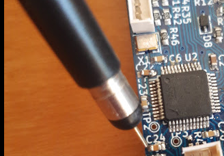

I have a board, with STM32f303. It generally works fine, but I am using the opamps and they are causing me trouble. I have set them up to have PGA of 16, and be internally connected to the ADC, and have test points on my board where I can measure the opamp output voltage. I can read the input voltage on the resistor-capacitor feeding it.
I observe that the opamp has almost exactly 100mV in (actually 102mV generated from a 4k7 pullup to 3v3 and 150ohm to ground, but only 1V out. It seems to be quite poorly defined on output, going between 0.8V and 1.35V. Obviously I expect 1.633V from 100mV*16 gain.

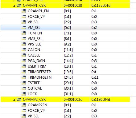

Registers are set as below, read out from the chip by the debugger while running; i.e. the actual values.

I have tried setting calibration values, to no avail, manually setting TRIMOFFSETP and TRIMOFFSETN to the extreme values, but it doesn't get anywhere near central.
I also ran :
hopamp1.Init.Mode = OPAMP_STANDALONE_MODE ;
HAL_OPAMP_Init(&hopamp1);
HAL_OPAMP_SelfCalibrate(&hopamp1);
HAL_Delay(50);
hopamp1.Init.Mode = OPAMP_PGA_MODE;
HAL_OPAMP_Init(&hopamp1);in the startup bit of main, and this generated different trim values, but still stayed near 1V.

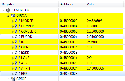

GPIOA registers as in the pics below:

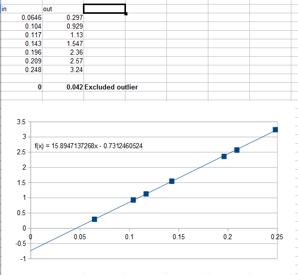

So I went back to school, and sat with my multimeter, plotting input vs output on the broken out opamp4, and got the below:
Dead straight small signal gain line of 16... but nowhere near through the origin. It seems this isn't really a rail to rail opamp, it's a kind of within 50mV of the rail opamp. The datasheet says CMIR 0-VDDA, and the input offset voltage is listed as 4mV maximum calibration range 6mV all conditions... nowhere near the 50mV I'm seeing.
I have another board running ST firmware from the MCWB, and that has a very small offset. I can't get my head around the code they've used to set it up... have they done some magic calibration, or is my chip just knackered?
Is this compensatable reliably, if, say I go and make thousands of these and don;t want to be trimming on a production line?
