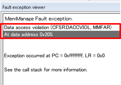

MemManage Fault occured in ITCM when I changed the system clock and DMA channel.
Does ITCM cause errors? What are the causes of errors?
Any ideas?

Does the program just disable access to addresses near 0 in MPU, to trap null pointers dereference?
2022-08-04 6:18 AM
ConfigMPU() would certainly be something to review, or enable/disable in a bisection of the offending code. Could also isolate to specific slots within the MPU

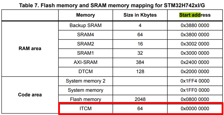

Does this mean I need to enable access to ITCM(0x0000'0000 ~) on the MPU?
For example, can data overflow from another area (like SRAM4 area) and access the ITCM area? Similar posts on ST Community seem to indicate that "memcpy" write data to unintended areas.
<https://community.st.com/s/question/0D50X0000AvfBVKSQ2/random-hardfault-bug-with-stm32f730>
