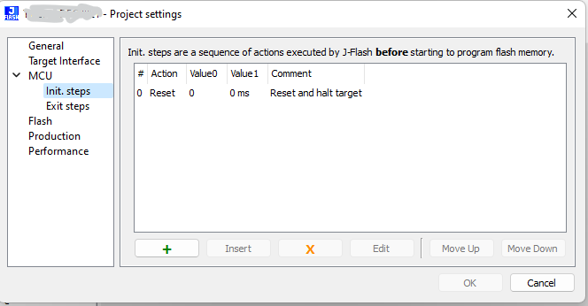

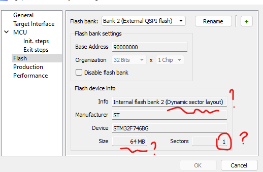

Below is the only config dialog I could find related to the QSPI.
What else is missing?
The flash indeed is mapped at 90000000. The size is 16 MB though it should not try to touch addresses not contained in the program file, right?

Their J-flash project does not have any init steps or script...
It perhaps should..

Aren't these things inside the .jflash files? The main scripting for the connection can be selected in the MCU tab, as I recall
