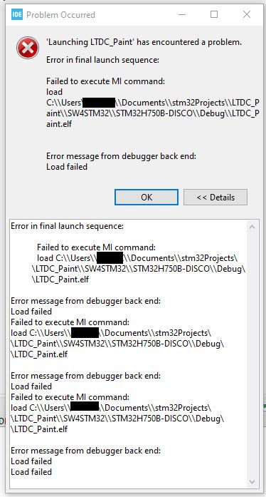

I bought the STM32H750B Discovery and wanted to program a first example "LTDC Paint" on the demo to start.
I am using the STM32Cube IDE version 1.9 (default installation, no changes made).
Procedure:
- File -> New -> STM32 Project -> Examples -> select the Discovery Board -> select the LTDC Paint example -> Run LTDC Paint
Then I get the following error message, see attachment:
"Failed to execute MI command.... Load failed ... LTDC_Paint.elf"
Which configuration did I miss?

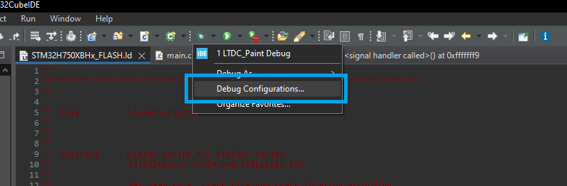

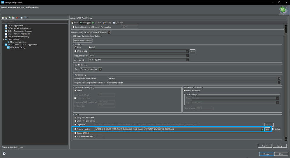

And after further analysis I observed that the used example in this case use an external memory.
In this case you should set the Debug configuration in the CubeIDE to accommodate this.

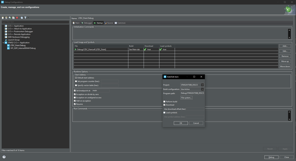

Hello @pk84
My bad I forgot to mention this part in my reply.
In fact since the example project is stored and executed from external memory you need to flash the "ExtMem_Boot".
The boot project take care of the init of the QSPI interface.
The boot project could be found under "STM32Cube_FW_H7_V1.10.0\Projects\STM32H750B-DK\Templates".
Import the "ExtMem_Boot" to CubeIDE and build it.
Go to the debug configuration for the LTDC Paint example project and under [Startup] add the download of the ExtMem_Boot" binary. (check screenshot bellow)
Kind regards,
Semer.

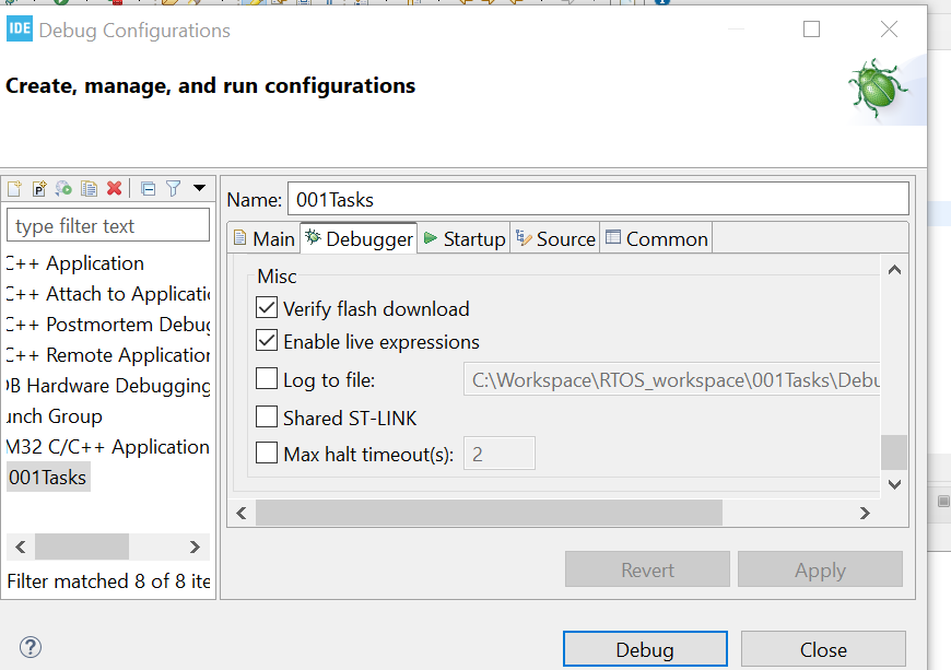

2025-07-22 3:24 AM
The appearance is changed. It is now on top of Misc

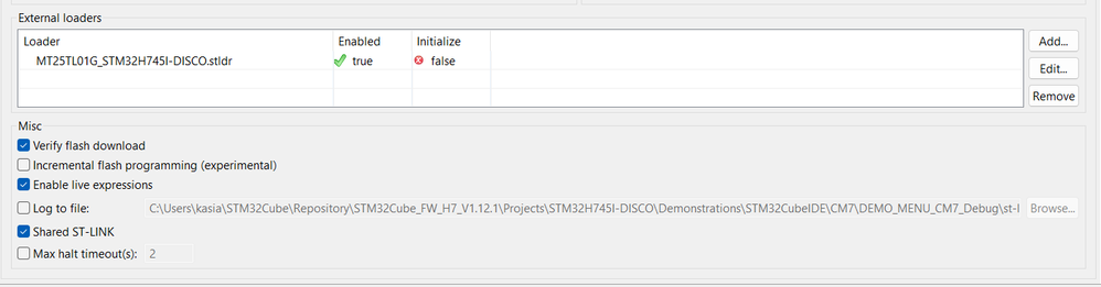

2025-10-07 1:05 AM
@Semer CHERNI
Thank you for the solution. It worked flawlessly for me on the STM32H747-DISCO as well!
