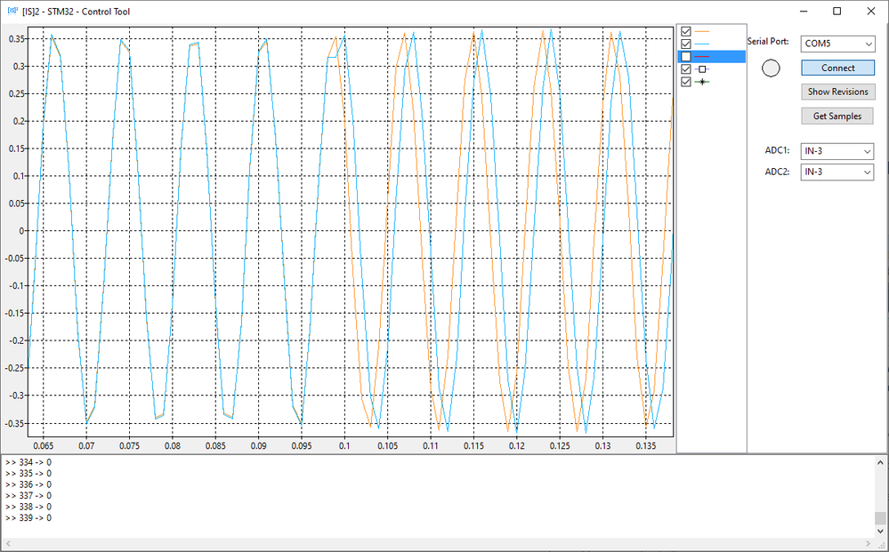

For debugging I sample the same pin, namely PA6 which is connected to ADC1 IN3 and ADC2 IN3. And I discovered that sometimes, ADC2 "jump" one sample.
See attached drawing where ADC1 is in orange and ADC2 in blue, horizontal axis is the time in ms, input signal is a sine wave at 100 KHz.
What could cause this jump?

However, I think I found a fix: I just needed to increase the sampling time of ADC1 compared to ADC2.
Probably meaning that DMA transfer is triggered by the end of conversion of ADC1, not taking care of the status of ADC2 (?!?)

After digging in the Reference Manual, I've been able to make some links between HAL setup by CubeMX and ADC registers...
Strangely enough, when recompiling the project, the acquisitions were stable, but shifted by one sample between both ADCs (but no more jumps).
Thanks to RM, and long time spent trying to fix it, I got a solution, with only 1.5 cycle sampling time on each ADC and absolutely no delays between the two ADCs.
I can't tell what was wrong... maybe around the configuration of DMA (currently ADC2 is set to Regular Conversion data stored in DR register and it works fine...)
