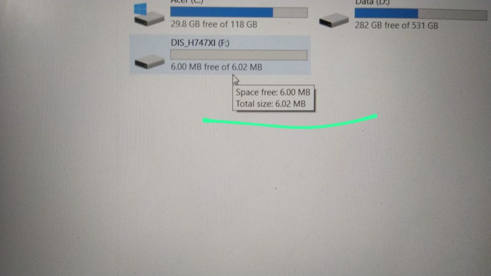

Stm32h747i discovery kit comes with an 2mb flash memory, I am trying to run an example project which is pasta detection based on this blog
AI:How_to_use_transfer_learning_to_perform_image_classification_on_STM32
but after some how after flashing the code, camera input is not going to the board and it is showing 6 mb available flash memory. I dont know how it got increased all of a sudden. And B-cams-omv not getting detected, even usb web cam example not working from FP-AI-VISION1 pack example

Not sure where you are seeing this.
STM32 Cube Programmer?
The board has some external QSPI memory, doesn't it?

It is seen an as an mounted device, that image is from my pc. And about QSPI memory in the data sheet it was like
Quad-SPI Flash memory Two 512-Mbit Quad-SPI Flash memory devices (MT25QL512ABB8ESF-0SIT from MICRON) are fitted on STM32H747I-DISCO in positions U3 and U14, making possible the evaluation of the STM32H747XIH6 Quad-SPI interface.
